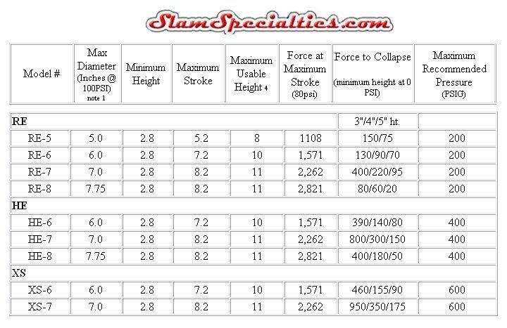

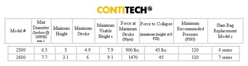

so what is the lift difference between the contitechs and slams?
check out www.slamspecialties.com
