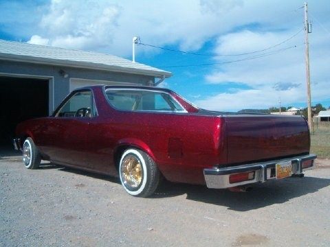

A FRIEND OF MINE HAS A 86 CHEVY EL CAMINO AND WANTS TO KNOW IF A 20X 8.5 WITH A NEG. 18 OR NEG. 6 OFFSET WITH FIT AND TUCK. THIS WHEEL HERE FOOSE.

-6 wouldbe a better shot but still close. I would see if they have anything in a positive offset. What kind of price he getting?

WE TRIED MY 22'S WITH A POS 30 OFFSET THAT WAS TO MUCH. WHAT DO YOU GUYS SUGGEST, DON'T KNOW ON PRICES HE JUST WANTED ME TO ASK IF THESE WOULD FIT OR FIND A WHEEL THAT WILL. HE WANTS WHEELS ASAP HE'S RUNNING 13'S NOW. BUT HE REALLY WANT 22'S WHAT ARE HIS OPTIONS FOR 22'S FROM MHT.

You can run a zero to neg 6 off set with a 4.5 backspace and will fit like a glove.

YOU'RE GONNA HAVE TO NARROW THE FRAME RAILS IN THE BACK I GOT AN 85 EL CAMINO AND I GOT 15x9'S IN THE BACK AND THEY RUB THE OUTTUR FENDER WELL AND I HAD TO PUT A SPACER TO CLEAR THE FRAME. THERE'S NOT TO MUCH ROOM IN THERE. GOOD LUCK.

Yeah, but from lip to lip a 9 inch wheel is really 9.5, the 8.5 from lip to lip is going to be a 9.
