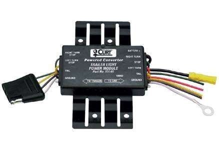

one of these.
This powered converter adapts import and domestic vehicles with separate turn and stop lights (3-wire system) to standard trailer tail light wiring (2-wire system). The unit is powered directly from your battery, elminiating the current draw from your vehicle's stop/turn light circuit. This protects your vehicle's sensitive electronics, ensures that sufficient current is available to the trailer, keeps the trailer lights burning bright, and allows vehicle bulb-out detectors to function properly.
This 10 Amp unit is CURT's standard duty model. It is ideal for most applications. Trailers with very high current requirements should consider the 20 amp version.
Calculating Your Current Requirements: You can calculate your trailer's current requirements using the following approximations. Simply figure out how many of each light type you have and add up the total current draw to select which model you need. -- Each stop/turn light pair: 2 Amps-- Each tail light pair: 1 Amp-- Each pair of clearance/market lights: 1/2Amp
Specifications:-- 3 to 2 wire conversion-- Input Connector: Splice-in-- Output Connector: 4-Flat Vehicle End Connector-- Power Connector: Spade Connector-- Load Capacity: 10 Amps-- No HD flasher or converter required-- Separate power circuit eliminates current draw from taillight circuit

i have that its from fbi called a tac unit
bodydropped85's avatar
bodydropped85
then i guess you dont have it wired right?
