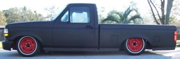

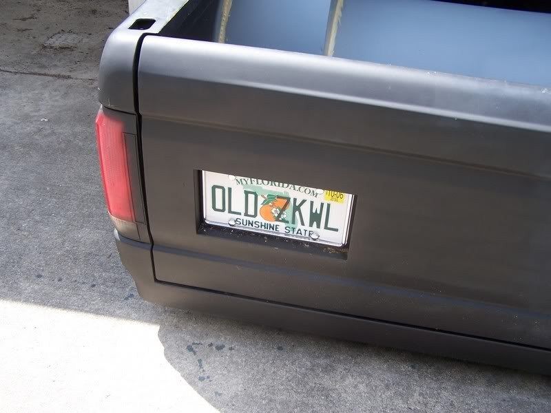

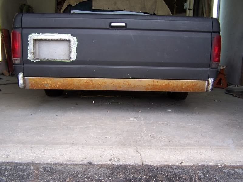

was wanting to show you guys some progress on my 93 f150 i bought the truck an it was a bag of nightmares over the last year an half ive tryed to get it to a state of worthiness has to put in a new notch brackets replace everything the prior owner had on it .. so heres some pix .. the atenna,emblem holes, mirror holes, 3rd brake light were shaved added a cando roll pan an tag box thanks scott.. a suicidedoors.com notch cover .. suicidedoors.com lower an upper bag bag brackets for rear .. custom parallel 4 link w/panhard bar slam 7s in the front 8s out back all 1/2-5/8s fitting 5/8s line smc watertraps smc slow downs for all 4 corners except for lift on the front avs 7 rocker switchbox 2 az compressors a sd.com 12 gallon tank square d press switch 47 chevy clip on mirrors an rhino billet double d mirror... brand new chrome doors handles an locks.. soon to come is shaved drip rails shave bed hole pockets shaved taillights an add some tba taillight you will jus have to wait an see take off the 5 inch cowl hood back to stock hood relocate tailgate handle an shave both gas doors an sheet metal the bed sides an floor.. so keep a look out .. here some pix ..

Looking pretty good bro.. gotta love the old skool
1twztdwagon
thanx bro its come alon way still have a ways to go

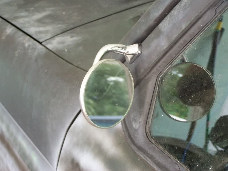

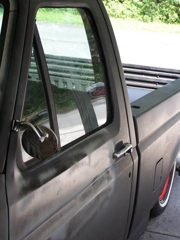

I've got a 1990 model and I hate the stock mirrors that are on it. Which ones did your truck have? I have the ones that has the huge brackets bolted to the doors. If you have the ones that bolt to the top of the door I might be interested. Truck is looking good! You don't see many of these fixed up...
1twztdwagon
those mirros got dumped in the trash LoL ya they were the ones on the top of the door an they look oversized for the truck LoL thanx guys

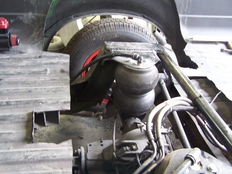

localanesthetic
hey man looking good...do you have anymore pics of your air setup front and rear. gonna be cutting mine up this winter finally...if you dont wanna post them you can email me at cloud99r2@yahoo.com..just make sure the subject of the email is bold cuz i get alot of spam lol thanks
