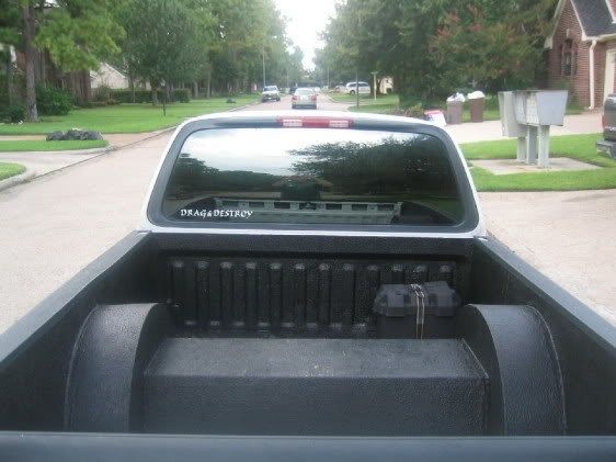

lets see some pics of sheetmetal beds so i can get some ideas on where i want mine to go i'm redoing the notch and decided to cut more on my truck and would like to see pics of tubs installed in the back along with raised floors and such . reson for all this is bigger wheels which will be going on come the first of the year . so i'm looking for ideas if any of your guys have any

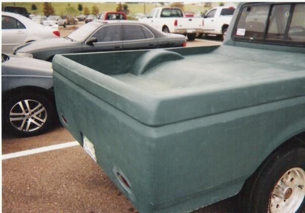

thats my bed...

i used coupler nuts,welded them to the bed then i could run my bed bolts up from underneath.

eric f150 what size notch you running and what size wheel. I'm trying to figure what size notch for 24's out back and still lay out are come close using a 35 series are 25 series tire i'm not gonna be driving the truck much on trips just around town mostly

its a suicide doors 10" notch but it was welded about 1" higer on the frame. the wheel tubs are 34"... im only on 20s, but i am almost positive that 24s will fit. im sure 26s could FIT haha but may not lay out on the 26s. i did WAY over kill thats for sure. i didnt know anyone around my area with a bagged f150 so i bought the biggest notch so i didnt have to redo it

i got an 04 f-150 heratige 97-03 bodystyle and got that 10"suicide doors notch. bagged on a 4link abd i bodydropped mine 5 inches, cut off the rockers and such. I put it all together for a 275/25/24" tire standing 29&1/2" tall and i still have like 2" of notch left. if that helps.
