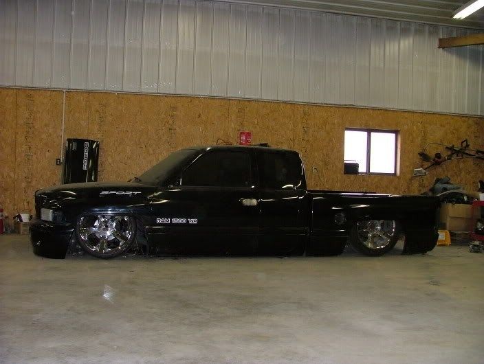

I bodydropped a 2000 ram extcab and evidently when we re-positioned the cab we bent the tranny fluid check tube. I can not tell what the best way to fix this. it leaks severly and i would like to know how /if this has happened to anyone? anyone have any ideas on how to remedy this?
