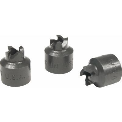

they have spot weld bits. Get on google.com and searh for them
Sickcivic
yeah we use spot bits as some call em they are straight u just dont drill all the way threw u drill untill u hear it pop and go to the next one is all
TwistedMinis
Spot weld cutter. Best 20 bucks I ever spent (not reallly, but useful).

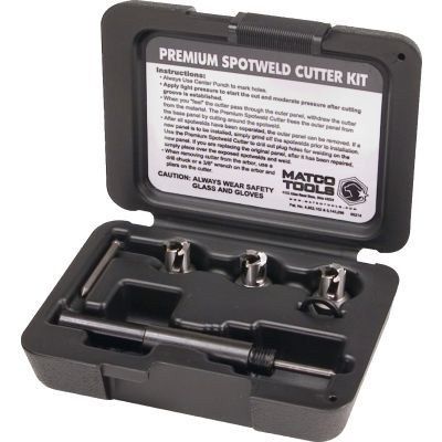

matco spot weld drill bit kit. i love that thing. just center punch the spot weld and drill away. its just a minature hole saw.
