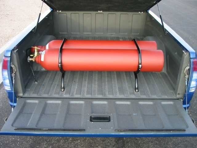

hey bro you can lease a bottle,here where i live its like 2 bucks a,month for the bottle,then 35 bucks to fill it..not sure in your area?check the welding supply stores.then get a good regulator.run the line from the regulator to your tank pretty simple realy,i whould say leave one comp hooked up as a back up it always sucks to be layed out and have no juice in the bottle..and as far as how long the last that all depends on how much you hit switches bro..play alot =fill alot know what i mean..hope this helps man..

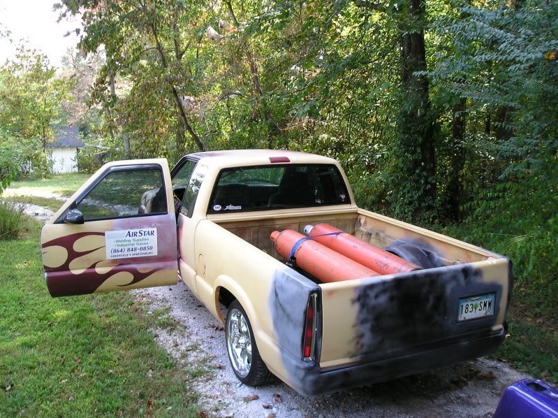

Love my nitrogen. Cost $800 for the entire setup...I bought the bottles. And bought the brackets from Ekstensive. Fill both bottles once a month.

I lease my big bottles(same as above) for 40 a year from Airgas. It costs 15 to fill them up. I have a AZ for back up air. I'm all hydraulic line and 1/2 valves. I love nitrogen. You don't have to listen to the stupid compressor all the time and you don't have to watch the gauge. Just hit them as much as you want of course until you run out, but that's why i have 2 tanks.
