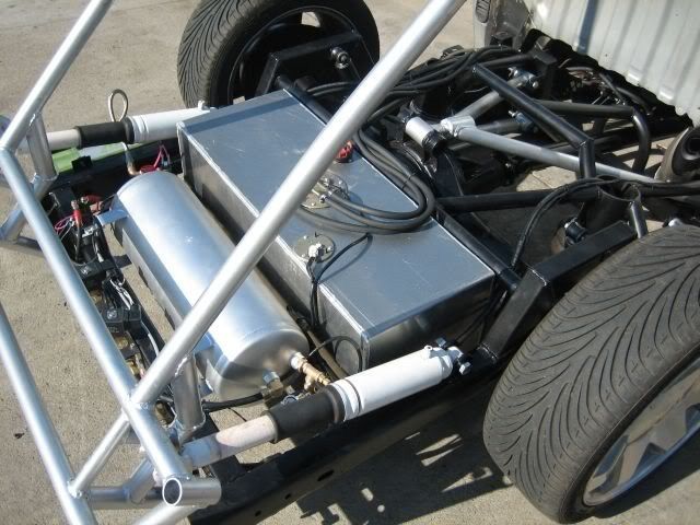

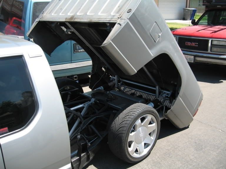

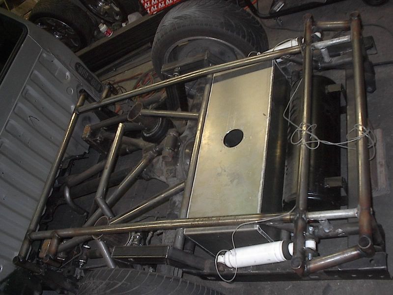

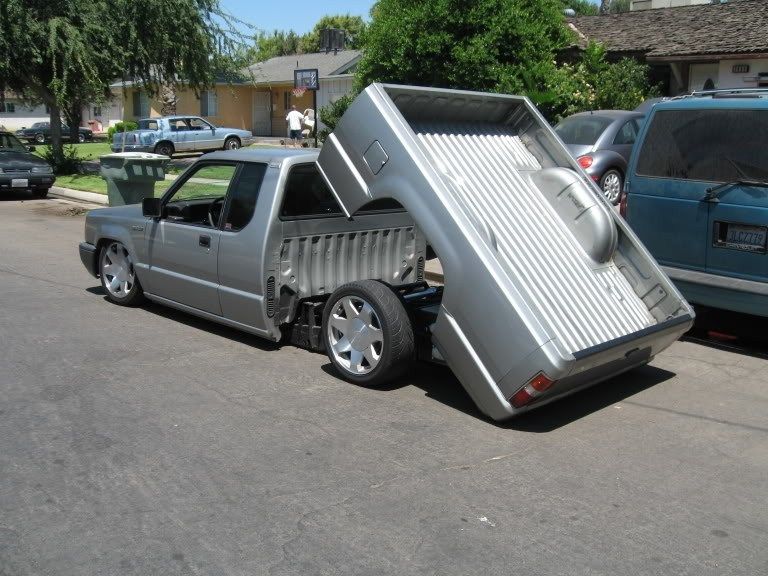

i got one in my profile the 83. used bimba cylindar. back in the day
mtm's avatar
mtm
so air shocks are strong enough for that? hmmm i always wondered if they could be used just didn't know if you could get enough pressure to em. I guess now i know...nice truck by the way
onehot69stepside's avatar
onehot69stepside
he said it takes 90psi to lift it, but only like 20psi once its up. I didn't finish hooking up the lines for him, he kinda ran outta money.
