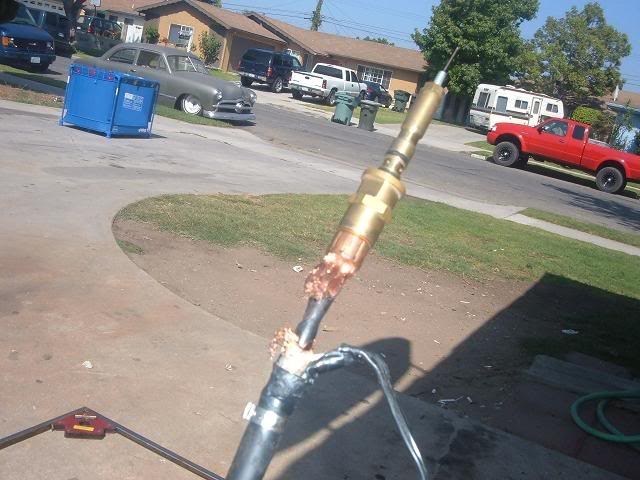

well this welder is about 2 years old (hobart 140) every thing works normal but when it comes down to weld it seems like it has no ground. i checked all connections replace ground cable same thing . what i noticed a week or 2 ago the ground clamp was getting hot i didnt know why...any help out there

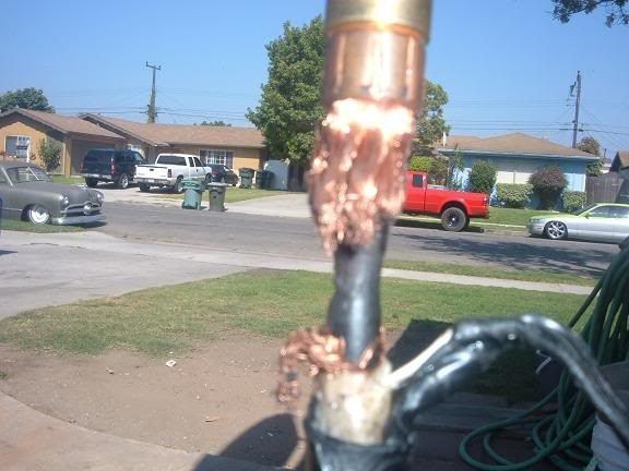

ok yeaup that was the problem thanx alot i took a picture of what happend
1 LoWfUKn RaM's avatar
1 LoWfUKn RaM
what i did to fix it i had a roll of 4ga speaker wire and i took the wire outta of it and added to the gun i added alot works liek before now. i also just order a new gun for it
