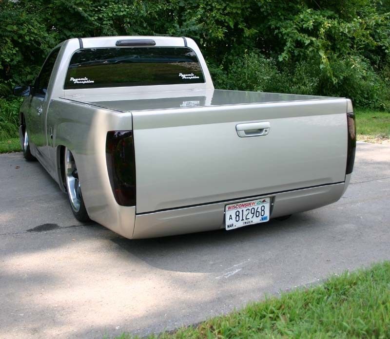

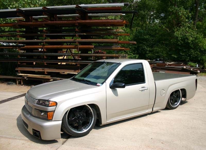

We have just finished our prototype truck for our new airride setup for colorados and canyons. It is laying stock (non z'd) frame on 20's running our tubular upper and lower control arms, our wishbone rear three link and notch. This uses the original gas tank and straps raised with our tubular upper and lower crossmembers. This truck also has our raised tubular trans crossmember installed.

um, i thin your guys work is phenominal but wouldnt a z help to not drag on the lower crossmember where the arms mount, eventuallly you will drag through the lower arm mounts, at least comes across that way from the pic.

Sure it would be great to be able to z the front clip. That thought crossed my mind. Not everybody has the capabilities to do that. If a customer personally desides their truck needs that then great. I don't want to make it manditory to get it on the ground. Our parts are designed to reuse as much of the factory frame and parts as possible to keep down the time/cash for the installer. I can't help the fact that GM designed this truck to make it nearly impossible for the regular Joe to get one of these on the ground for cheap. Gone are the days of the S10 with some bagcups and a fourlink and you would be on the ground. This truck reminds me of how hard it is to get a dakota to lay hard. That is why you don't see many full frame layin Dakotas.

looking good as usuall, and do you know if his roll pan is steel? I really like how it matches the bodyline of the tailgate
