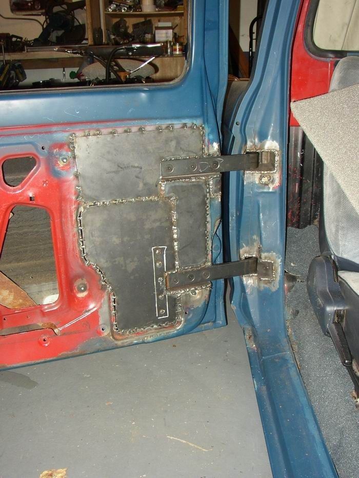

what is everyone doing to brace there doors?.
..just a plate on the bottom of the door, over the hole? or?
searched and didnt see any good pics or anything..

as much 1x1 you can really. brace the door up and the inside of the piller really good

The last one we did, we used 1/8" to fill the hole and some flat kinda like Micheals above, works really well

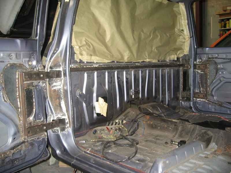

seth..why a piece of 1x1 across the back wall??...seem to help?

the bar was put in the back of my cab because the back of the cab was flexing...

Oh yeah i had to add support to the side of my cab, because the extended cab part was flexin too.
