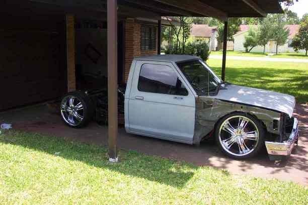

scrapinregal
we had 18's until the 22s came in the picture now it barely lays frame on 22s witn no b/d
