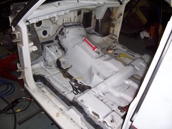

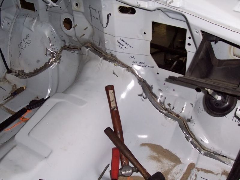

on my s-10 which is basically the same thing i never actually sectioned the firewall. i ground out all the seam sealer where the floor meets the firewall and drilled out all the spot welds.

so u basically cut the seem where the floor met the firewall? how many inches did u do?
do u have anymore pics?
