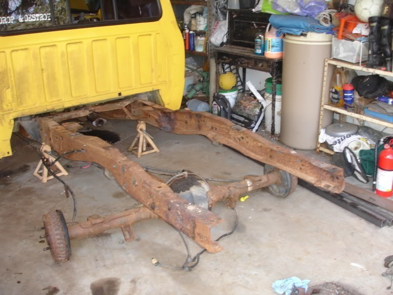

first heres my frame: http://i16.photobucket.com/albums/b23/need4speed01/Toys/DSC02047.jpg
heres what happen...my friend said he would pretty much bag my truck and walk me through it...well after i tore it apart and got all the parts he left..just refused to do...bastered...I cant weld lol..so its been sitting getting dust all over it and well i sat down one day and worked it out...here it isbelow is a pic of my frameStep1: weld in rear cross member
Step2: Weld in notch
Step3: tack axle on frameStep4: weld on upper link barsStep5: Weld on lower link barsStep6: Weld on bracketsStep7: Torch front spring mounts off
Step8: Weld brackets onStep9: notch tie rods and I-beam
Step10: relocate side engineStep11: put in raised cross membersStep12: hook up air managementStep13: notch for bedStep14: plumb the linesStep15: hook up fuel systemStep16: hook electrical back upStep17: reattach bed
for the 4 link my dad is a genious when it comes to geomety and my uncle can weld. I just need some ppl's opinions and what they think. This is my first time eva bagging a truck. thankz

so are you just starting or is it all done already, i only see a bare frame picture??
dragginduallydaily
hopefully your rails havent seperated since you pulled all the crossmembers out.. i like to atleast tack a temp member on the back before i hack out the old members.. good luck with it.
