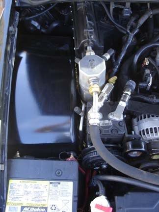

hombrehalfbreed
This is where im at with my 00 hombre i had my computer above my wheel, fuse box zip tied to my radiator support and that ugly abs crap everywhere, im just lookin for pics i have read all the post and its all the same ideas of extending wires to move the fuse box and comp. could any1 set me up with some pics??
