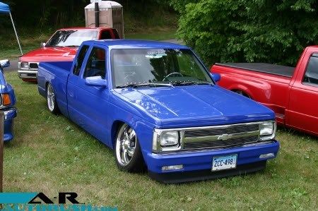

this was a 4x4 that was bagged. it now has a sfbd frame.

lets see some pictures, any of these 4x4s that have been air rided keep their 4 wheel drive operational.
