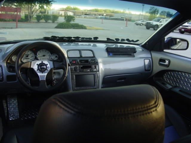

clean it, sand the heck out of it with 36 grit to be safe ( the more scuffed, the better)and clean again before you put fiberglass on it. i did my dash for my first time and it turned out great. i shaved my glove box with cardboard,( dont know if thats good or not) i cut it to fit, fiberglassed it and then fiberglassed while it was on my dash, i havent had any problems. but foam sounds good.
tofnlows10's avatar
tofnlows10
^looks sweet!..

dang joel dash looks real good,looks like you know what your doing
