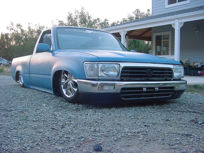

i have a 2wd 89 toyota pickup and was wondering if i need the 4runner hood when i do the front end swap. i am about to order all the parts and don't really want to order things i don't need.
streetsweeper1
No, the hood is the same. Just the fenders bumber, grille, lights and cornerlights is all you need
streetsweeper1
For the full conversion that is. You actually don't have to have the bumper. I have a 2wd bumper in the above pic.
rizz0's avatar
rizz0
i already have 4x4 fenders those are the same as 4runner ones right?
streetsweeper1
yes
