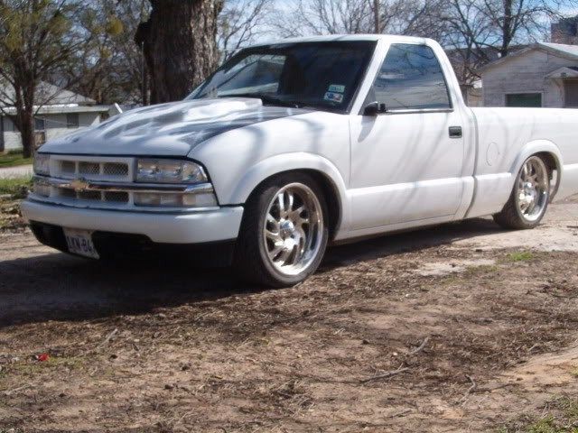

My wheels are 18x8 egale alloy 217 they tuck nicely

When I frist went to get wheels for my S10 bell tire told me it was a rare bolt pattern so i called them a bunch of idiots and went to Discount tire where a couple local minitruckers work and they hooked me up just talk to the right people there are so many wheels you can get for these trucks check on the classifieds someone was sellin 20's for an S10 for a grand L8tr

i use 20x9 with a 6inch offset rubs a little but tubuler a-arms should do the trickb
