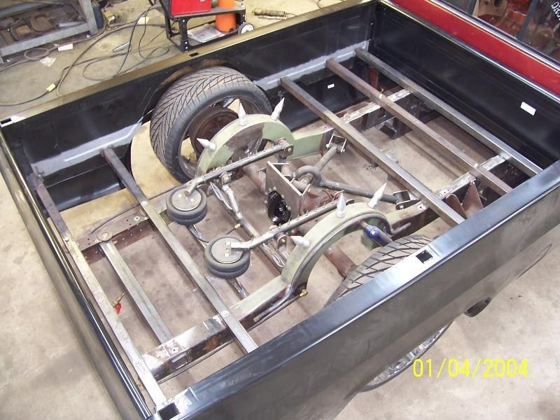

how is everyone mounting there bed??...when you backhalf your truck...
BodyDragginGMC's avatar
BodyDragginGMC
I made brackets to mount in the stock location.

jesse james welds his on there
/7
///RELAXED 720
Jesse James: bed mounts? bed mounts? U dont need no stinking bed mounts

but jesse james ain't no mini trucker...
aesthetikustoms
that rear setup up top is badass but i dont see any lower bars. dont need them?

I made new bed mounts out of box tube and screwed them up into the bed. Then a friend and I lifted the bed onto the truck and lined it up with 4 jacks. I got the bed parallel with the cab then set the height of each corner with a jack, then crawled under and tacked all the mounts. It went so fast, I almost forgot pictures.
almost.
dssur's avatar
dssur
about two hours later, all welded and good.
