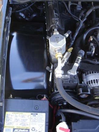

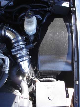

hay i was wondering if anyone has pictures or info on taking out inner fender wells on a 2000 s-10 some of the thinks iam not sure about is what to do with the abs and the computer and the fuse relay box and can i do it with out having to rewire anything thanks mike...

Ok heres wat me and lil shop of horrors did... i scrapped the ABS and they got new brake lines made to work with a regualr combination valve... i extended the wires on the fuse relay and they made brackets mounting it to the radiator support (its really snug haha)... the computer i didnt really have to extend much... i think just the wire from the a/c then they made a braket so that the computer was mounted on the underside of the battery trey... if u have nemore questions hit me up...
layinframe2k
i pulled the a/c and put the comp were the a/c use to be
