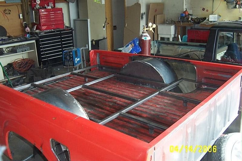

whats everyone using for their subloors when they build new floors? 1/2" box tubing or 1" ?? just curious im gonna be doin mine real soon and thought id ask! if anyone has pics of their subframe it would be appreciated!

i did mine with some 1x1, i think its 16 gauge or something, its thin, but theres not gonna be any weight back there NE ways

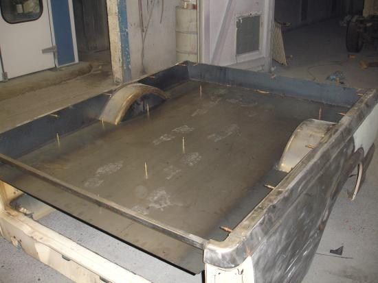

ok i have a few questions about the whole subfloor thing. so after you have your subfloor in like in the picture above...do you just lay in the sheet metal and tac it down like any other sheet metal work?

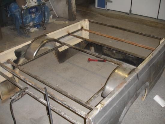

heres mine i tacked a couple bars in then cut the whole floor out and went from there
