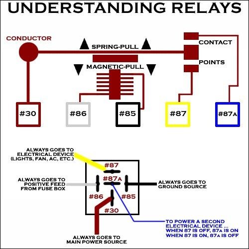

Its pretty hard to explain in a short amount of time so heres a few pointers. Ill try to answer as many questions you have.basically you need run fused wire to a distrobution block that splits it to 3 wires. run 2 wires their own 30/40amp relay. run the 3rd (use a thinner wire) to the power source of your popper brain power wire (should be red fused wire). Make sure you take care of wiring your ground as well. Use this schematic to help you figure out how a relay works. Wiring is cake once you figure out how it works.
