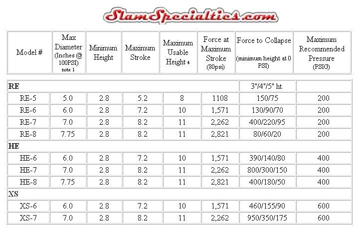

im going to be doing my 97 nissan hb and i need to know which slam bags i need? any help is appreciated.
whynotfab
The common combo would be 6's up front, 7's in the rear, although it's possible to run 7's up front too I'm sure with a little extra trimming/effort..
Then the series just depends on what PSI you plan on running.
RE - 200PSIHE - 400PSIXS - 600PSI
Here are the specs:
They are nice bags though definitely
