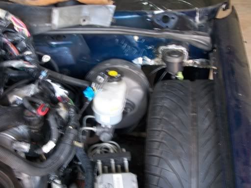

i was running a 255/35-20 tire is to big, and depending ont the brake booster a 9.5" will hit it
http://i62.photobucket.com/albums/h100/lwchev/Russels_camera_0391.jpg

do you want the clutch slave or the brake booster moved?
clutch slave you just move it up as far as you can, drill a hole, use a piece of thin pipe, weld it in there slanted back so it still attaches right and bolt it back.
brake booster.. u will prob need to end up getting a 7" from ebay and modifying the pedal rod. I think a 9" that comes stock in some s-series is gonna be too big for a 20x9.5 with a 255 tire.
