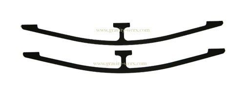

unless they are square i'd run these
www.gravity-werx.com
slamdamazda
yeah ....i have some round bars and bent the sh!t out of em....it sucked. sqaure bars are the way to go.
