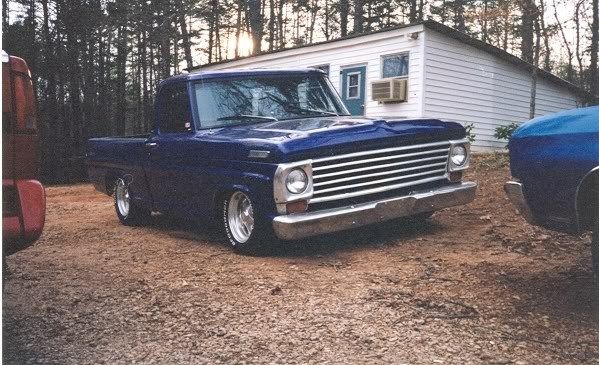

you can use 3 inch drop beams for 65-79 f100s, and the 73-79 trucks have disk breaks for the frt. i dont know about break boster cause i still have all my original stuff cause i havent had to mess with it. I also have cut the springs down just a lil bit cause a little gose along way. one of this pics has almost no spring in it and i had a shop bend the i beams but they could only get with one degree of camber. and the back i took a few leaves out to lower it. If this info aint got good gramer thats because i been out in the sun wirein my s10 and running new air line so who cares lol. oh and if you want to lay body then u gota change alot of stuff up frount cause the crossmember that holds the ibeams will hold you of the ground by more than a few inches and the stearin box is right at the cab with no room to z or body drop so that will be a pain.
