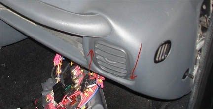

ok yall know the a/c vent on the passenger side of the newer model s10 dash?... how do u get it out?... i got the lil vent thang itself (the thing that pivots)... i want this out tho :
blazenide89
ok im guessing even thought by your post it sounds like youve already taken it out if you havent just pry it out with a screw driver.
JFcustoms
squeeze it together from the backside, should be a tab on both sides, and push it out from behind or pull it out while squeezing
sdimeondubs's avatar
sdimeondubs

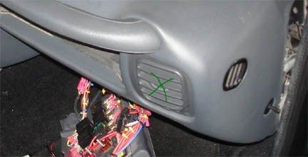

yea i cant really word it haha... ummm... well here... i got this part out:im tryin to get this outer bezel thing out... do i use a screwdriver for that?, it has sum clamp thang i cant figure out... or am i just retarded?...
lowgmc's avatar
lowgmc
you need to go from the inside pull out the glove box. there should be a 10 or 7 mm bolt holding it on. dont really remember but i broke mine prying it out then realized what i had to do. im almost positve you need to ge behind the glove box though.
sdimeondubs
Edited: 4/6/2006 11:45:09 PM by sdimeondubs
ok i got it... it was one screw, i had to take out the a/c ducts and everything... for that one screw...
