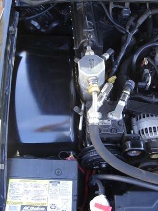

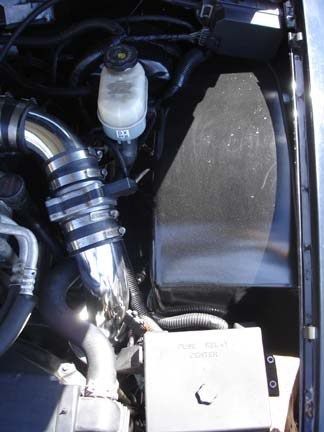

well idk bout 18s, but for twenties = scrapped the abs, brake booster outta a 93 manual s-10... welll.... just check the profile pics... here:
cruisinlowS10
your inner fenders will unbolt, everyone talks about cutting them out but they unbolt.however you will have to cut out some of the guts of your fender

when i had 18's i just cut out the tops of the inners and spaced everything up(abs, overflow and computer) and ditched the washer fluid and moved the fuse box down. You dont have to move stuff much for 18's
