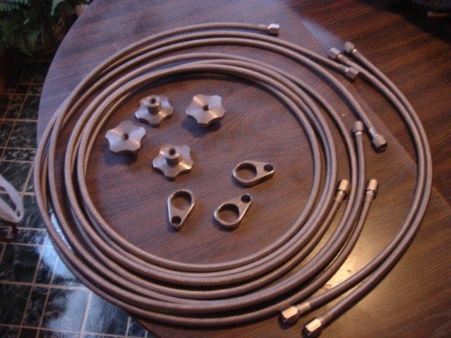

heres my stainless braided lines.... they are the SHIT.
brandon005
wish I had the money to drop on lines like that they look tight as hell
