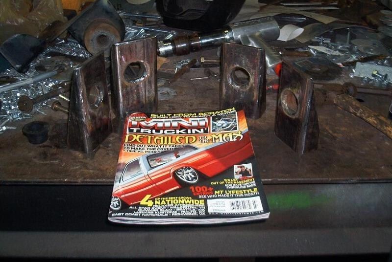

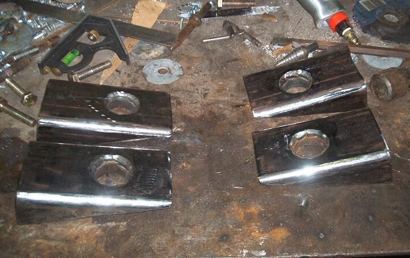

even cheaper, pie cut 2x3, im gona use 4 link bushings in there. may not be the best but its better than no rubber at all.i used a hole saw to cut the holes, and cut a 4 link sleeve in half and welded her in.
