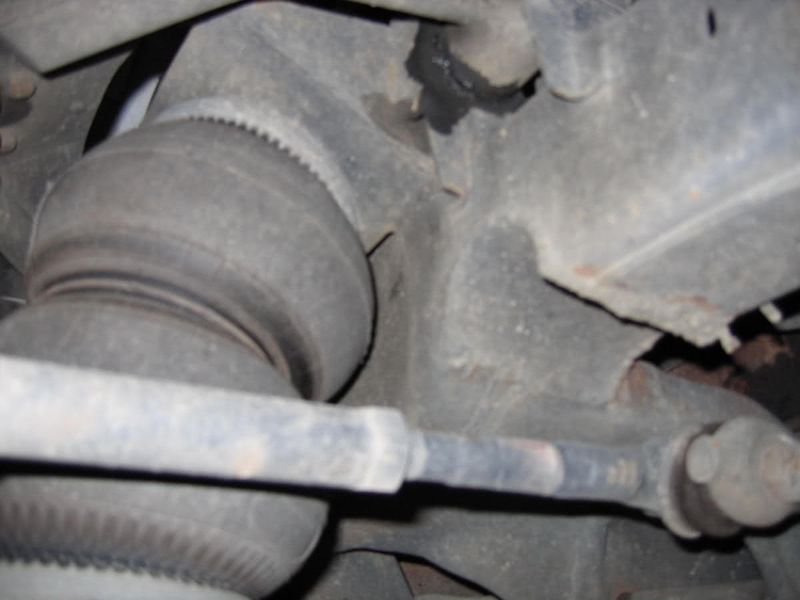

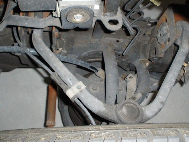

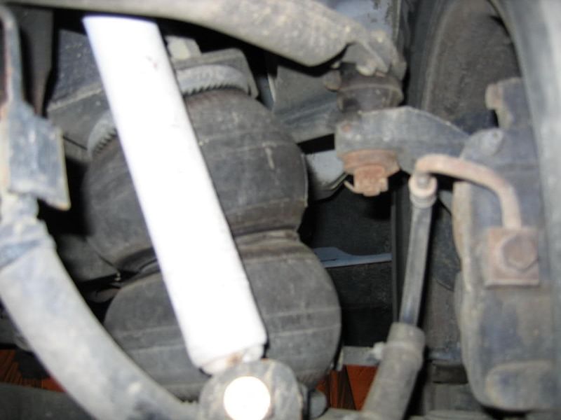

i have had 2600's firestones on the front of my truck for over two years now,no problem.i also have the shock inside the arms beside the bags,no turning radius lost at all.i made my own upper mount,remove the coil mount,use a tubular lower arm and remove the sping cup.make a new lower mount in the arm,angle the mounts and the bag towards the motor.my bag fills straight up and down no mater what,none of that acordin like crap.i can post some pics when i fix my scanner.
milkman64's avatar
milkman64
here ya go this will give you an idea of what i was talkin about.
