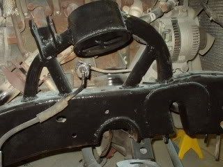

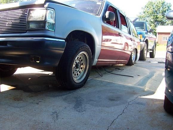

u can do the tube style uppers without bending tubing if you have to. Get in touch with DRP_YRZ. Thats how his are done. I just finished one with tubular uppers (bent tubing) on 20s. Gets full steering with airlifts, slams would give it even more lift. So you can get enough lift if u take the time to get your bag angles right. But if you can, I would do a yota clip. Control arms are where its at.
Here is a Pic of DRP YRZ straight tubing mounts. He's laid on 20s.
and this is the passenger side of the one i am working on at the shop. And yes, be prepared to notch for the tierods. I plated the side of the frame with 3/16 after since i took out so much for the notch.
