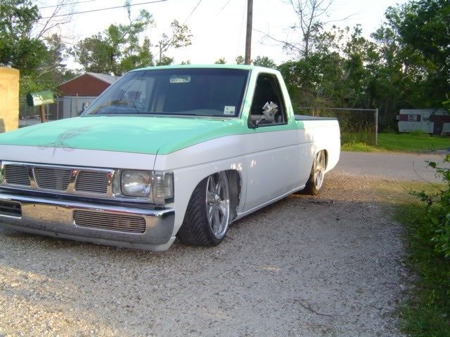

For sure, use something with a body line already in it for shaving. As far as the suspension all that's totally up to you and your fabrication skills. If you're confident to cut up what you need go for it if not i'd look into some arms.
kindalonismo's avatar
kindalonismo
Im body dropped on 18's and just used the drop spindles.. I cant speak for running 20's tho.
baggedhb
should be able to lay with the 2" spindles. maybe notch the LCA and flip the UCAs if nessicary....i lay on 225/40/18s with a notched LCA and flipped uppers no drop spindles.
bizanitch
I can lay on a 28" wheel and tire combo with stock notched lowers, flipped uppers, and drop spindles.
onecrazyzoo
Edited: 3/14/2006 9:57:30 AM by onecrazyzoo
layin on 28's huh??? Now I'd pay good money to see that. Assuming that the tires aren't coming out the top of your hood. But i'd still like to see it.
keele's avatar
keele
Same here. Post some pics

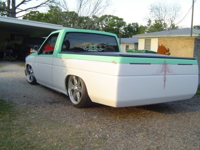

sublimity
mine dropped on 18 with just spindles lays frame
sublimity
sublimity
unusualfabrication's avatar
unusualfabrication
It says 28" wheel AND tire combo, that means that he can lay on 22's. A 245/30/22 is 27.7" in diameter. I would still like to see pics as well because the only HB that I have seen on 22's is the one that Duck built.
