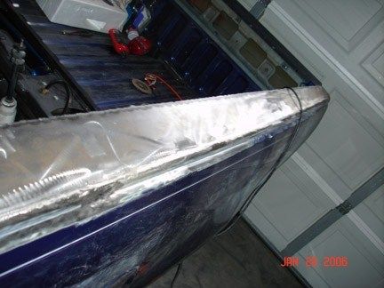

Im in the prosess of shaving mine right now. ive got the driver side done (minus body work). its actually not that hard to shave them if you do it how i did mine. I made a template of the top of the bed rail and tranfered it to a piece of sheet metal, then just welded it on. it took some time to weld down the lenghth of the bed on both sides, BUT it was worth it, It looks badass. it just so happens i snapped a bunch of pics yesturday, so ill post them up asap.

Allright here is a try at posting up some pics, i havent done it forever....
This is what it looks like under those ugly bed caps.
This is how mine is now (still not completely done)
