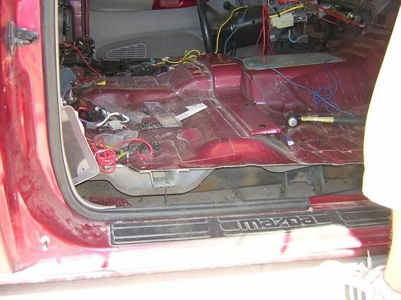

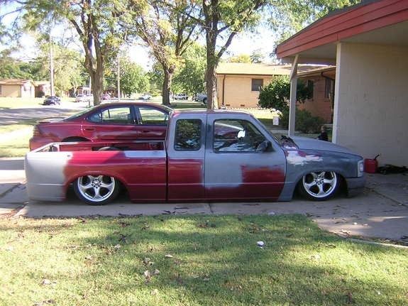

Well, it depends on how much head room you are willing to sacrifice. . .traditional you will loose space, stock floor you won't. You only need to redo the frame if you are doing stock floor. . . This is 4.5 on a 96 with a 3.0 V6
But it LAYS OHHHHHH SO HARD. . .ps those rockers are only there cause I haven't got to drag em yet. . .
