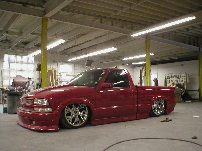

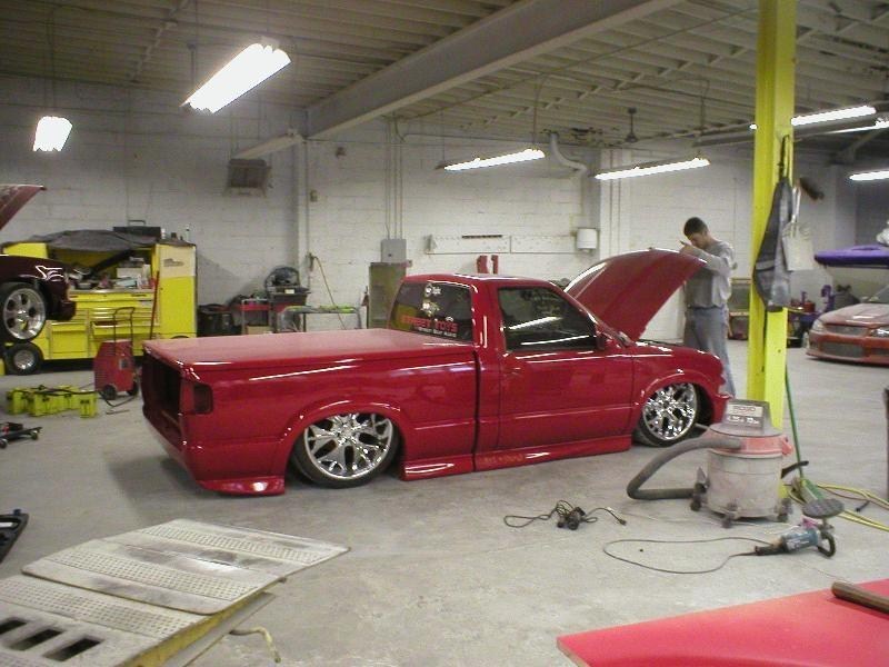

this extreme lays (kit) with the ridetech airbar and it has 22s out back

to address your question, pretty sure the s-10 weld in notch is plenty for 22s. youll need to change up the bag mounts tho. i bagged a dime on 22s and the back was about 1.5 from laying due to the upper bag mounts being at the top of the notch, but theres enough room between the axle and bottom of notch. this was also with 295/30/22 tires. theres shorter ones avaialable now.
