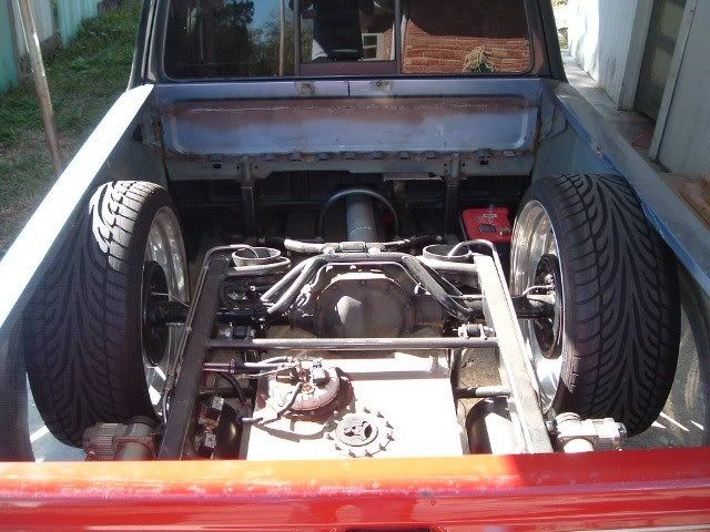

I got a pic of mine before I skinned it.
While the truck and body was layed out I just cut the entire floor out and built a frame out of 2"x2" tubing.T
hen made the floor out of 1"x1".
I probualy went a little over kill with the amount of tubing I used, but oh well.

heres a couple picures of mine... cut the whole inside out... but it was mounted front and back... just happened that way.... and then i built a 1x1 frame then set it on where you can see in the first picture that the bed is mounted to front and back. welded it to that.... welded the bolts down.... im leaving it like this( excpet in gunna get the bodywork done of course) and putting a wood bedkit on top of it.
