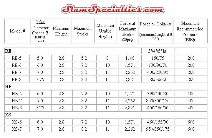

i would love to put in Slam bags on my '51 Chevy but i'm a little confused on which one to use. they have the RE, HE, and the XS all available in different sizes. i plan on sticking with my stock suspension setup instead of switching over to the Mustang II IFS. does anyone have any ideas on which bag i should use? all help is greatly appreciated. thanks.
whynotfab's avatar
whynotfab
The RE, HE, and XS are just to seperate the PSI ratings.

youre keeping the stock suspension, ie solid front? I have seen a kit that utalizes the solid front and uses two arms to act as bag mounts and such. it was VERY expensive though.
My dad has a 6" drop on the front of his 53 chevy pickup, with 3" smaller tires. this is still using the solid front. out back he is using a parallel 4link with coilovers, for an 8" drop.
