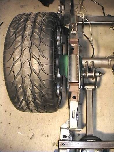

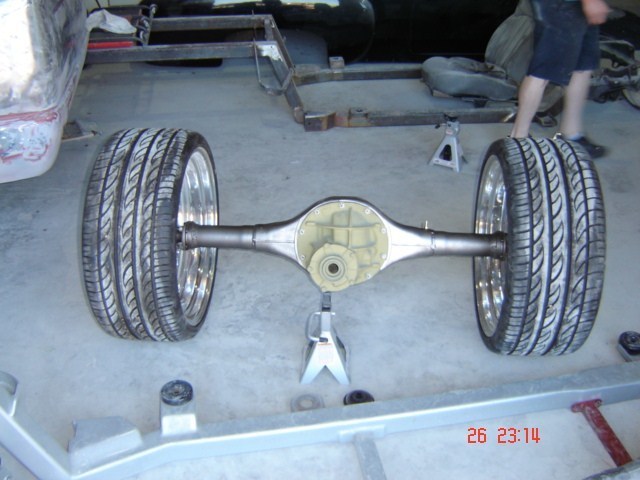

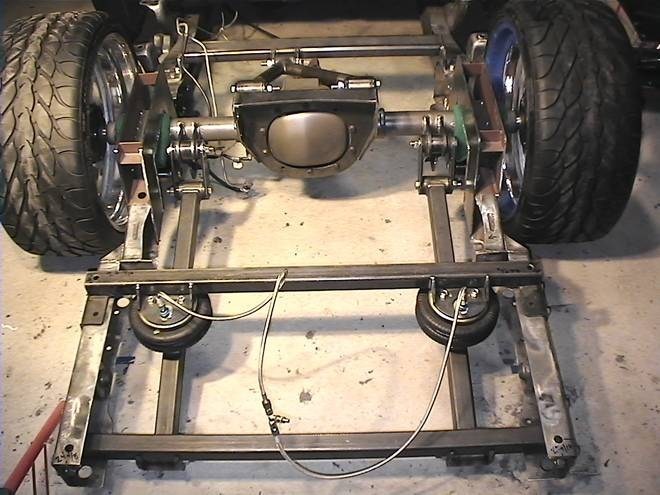

anyone know how much shorter gtcuztom and bagdx rearends are??...sent them both a pm but they have gotten back to me yet..
http://www.streetsourcemag.com/ViewOwnerProfile.aspx?Home=true&Profileid=38879
http://www.streetsourcemag.com/ViewOwnerProfile.aspx?Home=true&Profileid=2991
