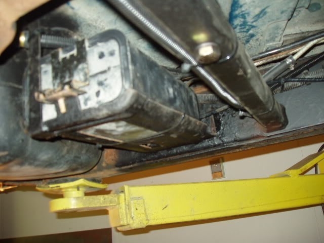

Here is one that was just relocated at the shop, I say just take the extra little time to relocate it, its not like its a ton of work.
