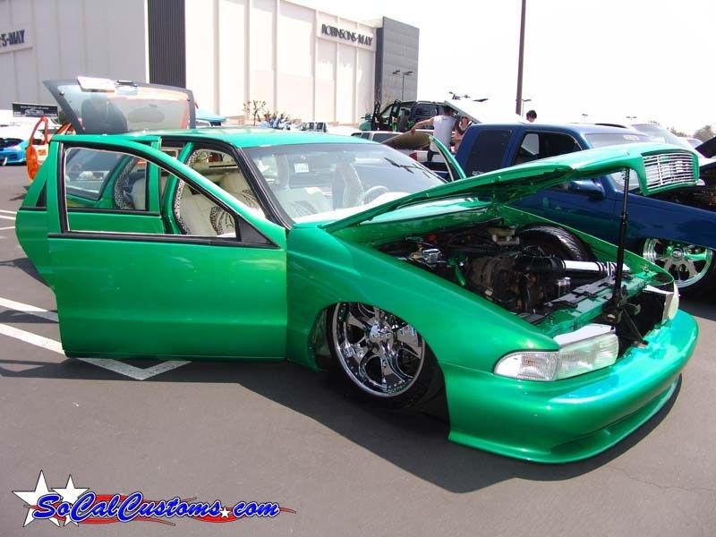

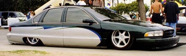

All depends on the car and the size wheel you want to roll. The caprices tires pushed the hood up. Little Rob's was done by IF a few years ago. The whole upper front clip is wedge sectioned to clear the 20's. There is also Jamie from ST who put bumps in the fenders to clear the tires.
For the most part these were all done traditional bodydrop style. Most cars already have pretty thin frames so stockfloor may be questionable.

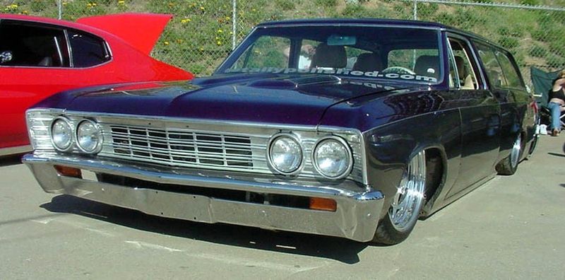

They only time a new frame would benfit a car would be in the case of unibody rides. Like I put most car frames are thin already. Cars usually do not require as much a BD as a truck. The chevelle is not even noticable because of the way the stock floor is shaped.Bring the Noize '06 coming February 20
