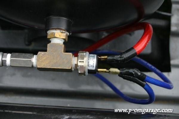

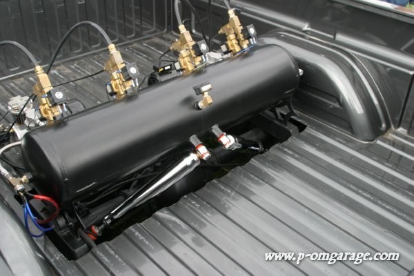

these are two pics I took during carlisle...air tank shock mounts? over kill pressure switch?

Holy crap it is a wonder he hasn't popped that Press. switch! Most little switchs can not handle the 15+ amps per compressor!
And buy the looks of the size wire he is running he is doing exactly that! Killing it!
LOL

i know that pressure switch is a death trap but i am more just confused by the shock mounts!

besides the shock mounts, i like the idea of putting the tank between the wheelwells.

can you say fry? cuz that's what'll happen to that pressure switch, that thing needs to trip a relay, or multiple relays that run those compressors. The shock mounts, well if it was reinforced good I can't see an issue, other than the stupid angle on em......

nice brackets holding the tank to the fram !

I like the shock mounts just hope the tank is mounted secure

ok. the owner of that truck hung out with us that whole weekend at Carlisle. Super cool guy. The tank is securely mounted to the frame with a couple of simple and nice heavy duty brackets. Those shock mounts are fine. The pressure on those shocks moving is not going to be enough to hurt the tank. The pressure switch is something else though. Thats a bit much. I do know that he had the suspension done by a shop...so thats their doing...not the Owners
