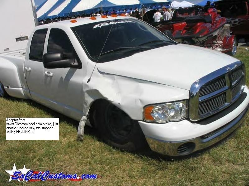

Well the cheap way to go is to buy adaptors which run in the 800-1500 a set then buy your semi wheels have the lip machined which i dont like due to the bead type on 16.5",19.5",22.5",24.5" is diffrent its a V bead where a normal tire is not i sell bolt on 19-22.5" dually wheels i can also get the adaptors that help correct the offset. Two things to think about when running semis, MUCH widder than your wheels so you will have to narrow rear end or...... Also thats AOLT or rotating mass you add. Semi wheels are very heavy not to metion the adaptors so starting and stoping is more work on the truck
outlawcrewcab's avatar
outlawcrewcab
Thanks to mark for these pics these where chromewheels.com adaptors Mark makes his own now is what im told
