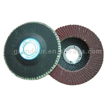

Die grinder with a flap wheel is the best way...the flap wheel- comes in different grits from like 36 up to 120...that will leave it smooth enough to prime it with some filler primer
Stock Sucks's avatar
Stock Sucks
plus you can get them from Lowe's or Home depot for like 5 bucks a wheel...3 or 4 should do a 350 block...maybe one more for aluminum heads cause the aluminum will clog
up the wheel faster
