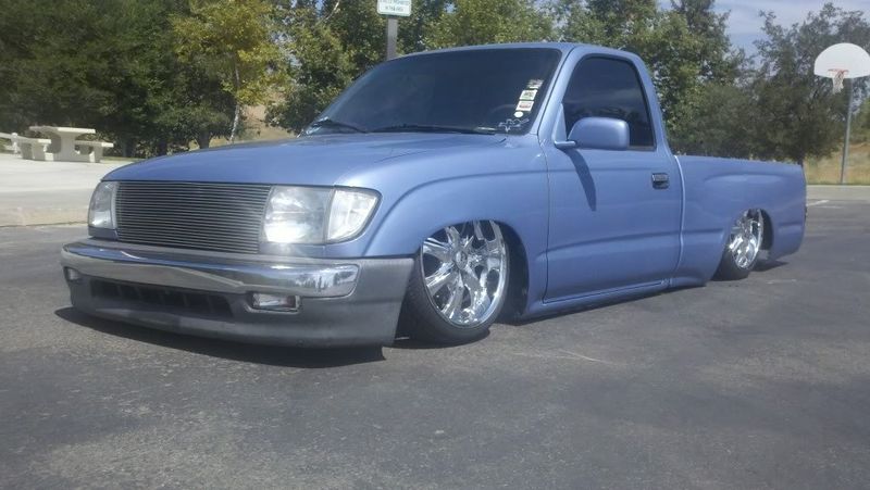

I've got stock uppers and lowers on a 98 and lays flat frame on 18z. Moved the upper arm up about an 1". I also have 2" spindle spacers and very little camber.
