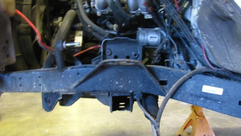

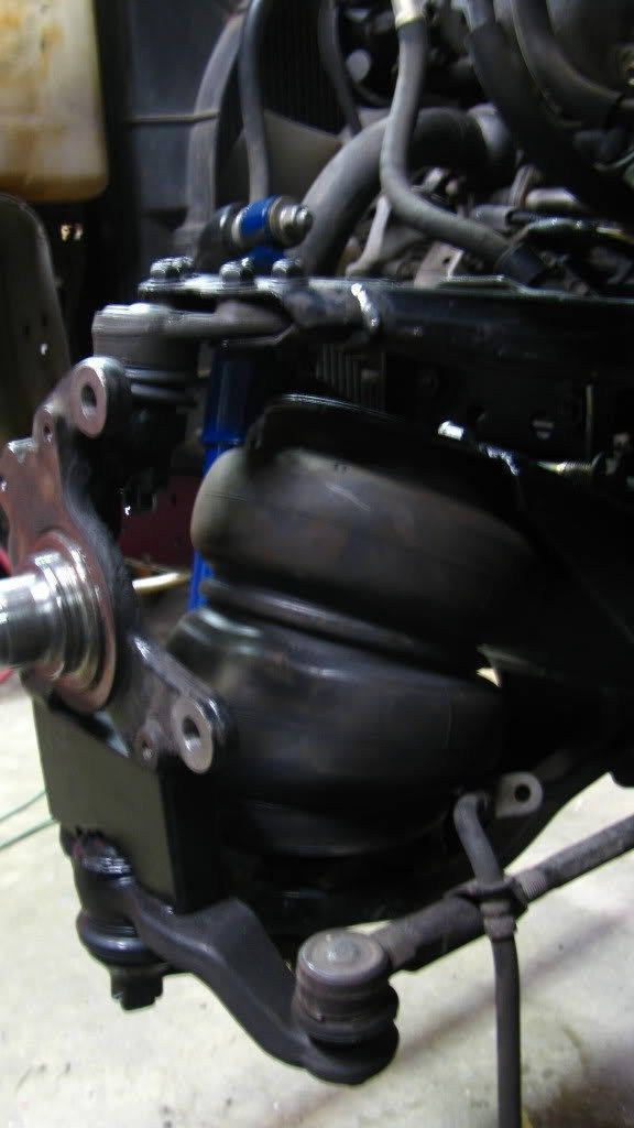

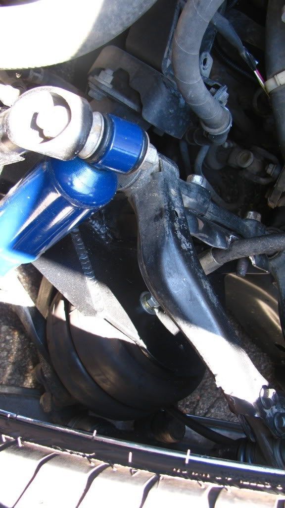

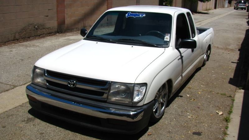

Ok i bagged this tacoma a while ago ,it got sold a few times but now its back to me to get redone .. im gonna lay it out flat on 18s with good size tires .i do these frontends with out Z-ing the frame ..

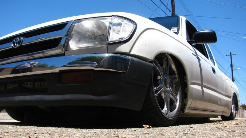

Dude, those are my old rims...huh??
thomasd's avatar
thomasd
yup... funny how shit gets around .... hahahaha
i8nt2lo's avatar
i8nt2lo
No shit. Minitruckers mane!! Good networking.

Did that upper plate start peeling up a bit?? Maybe it's just f'n with my eyes.
thomasd's avatar
thomasd

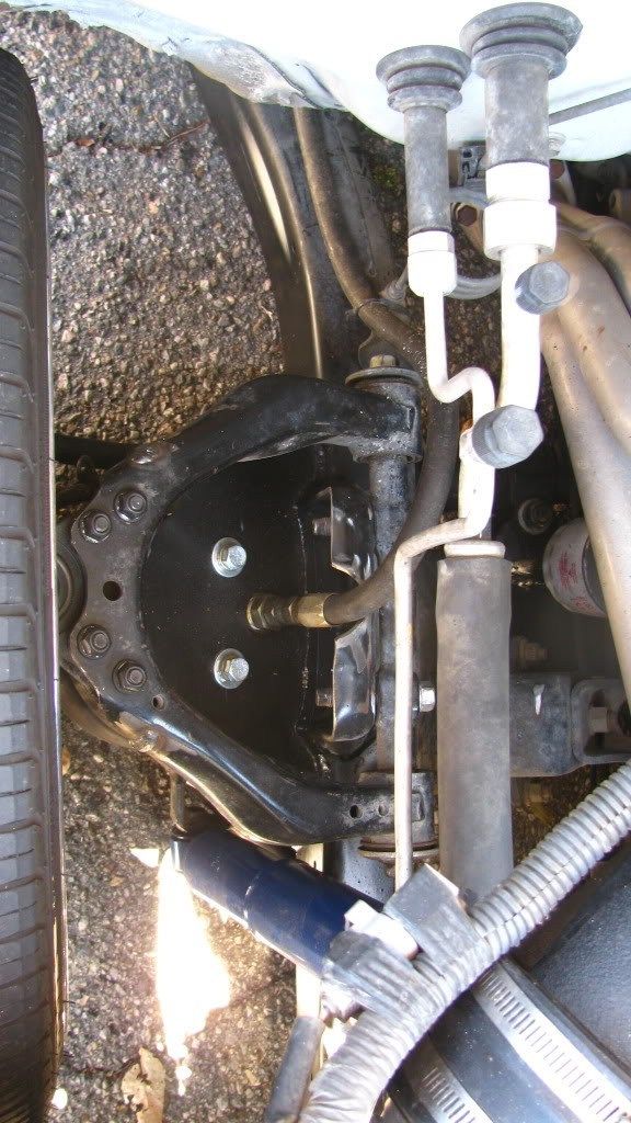

yea it did a lil .. thats y i make my own bag plates now ... they dont bend !! so i got a lil bit more done today ..

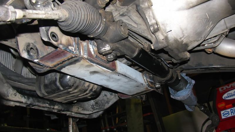

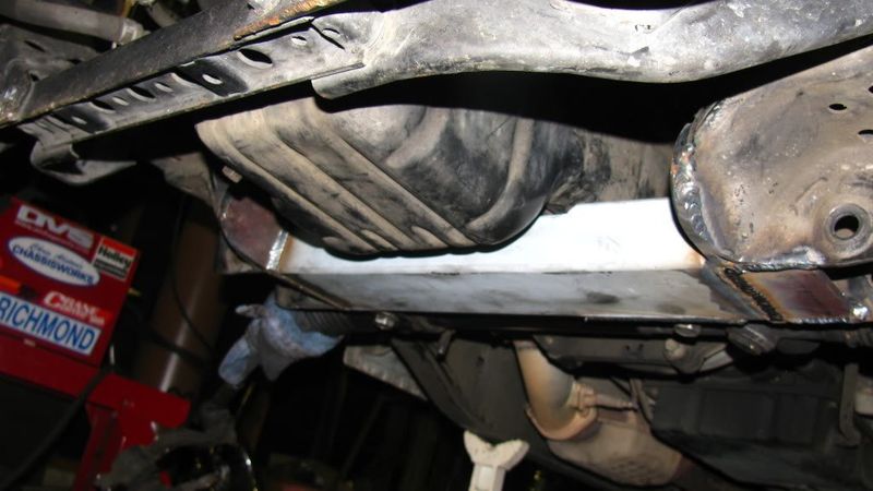

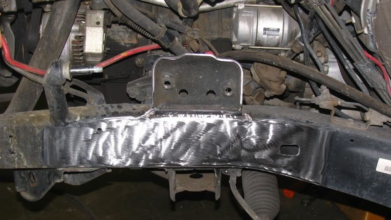

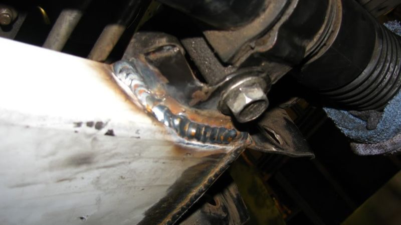

Ok boys and girls i got a lil more done on this thing today ...the new crossmember is in and the steering rack is mounted ..

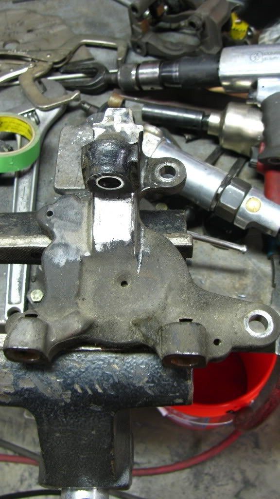

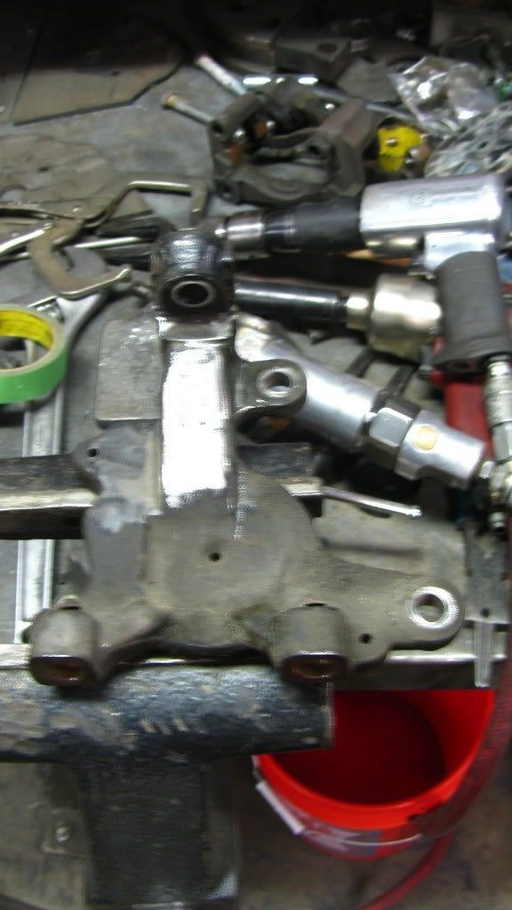

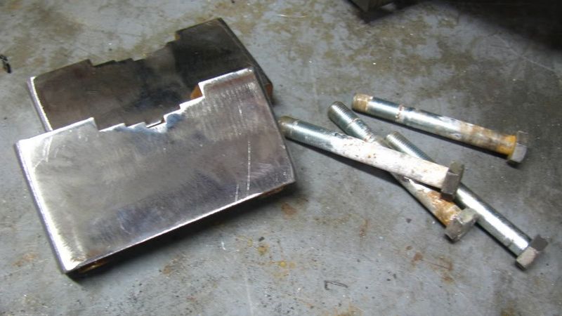

and these r the spindle spacers that i make ..

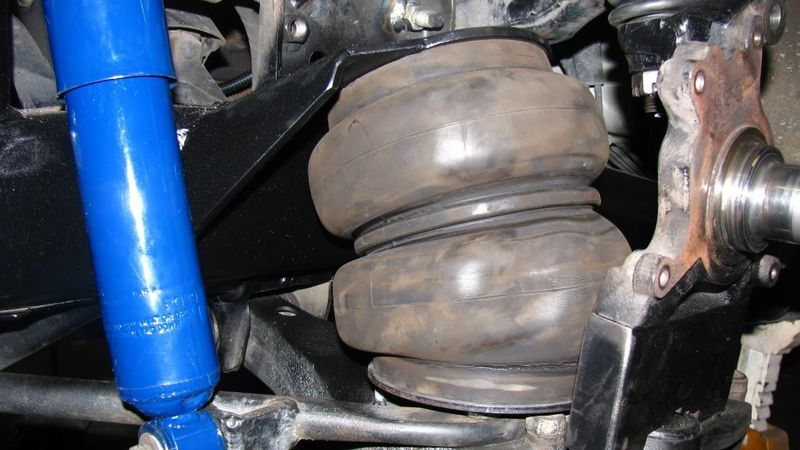

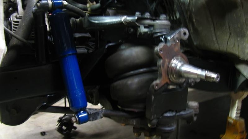

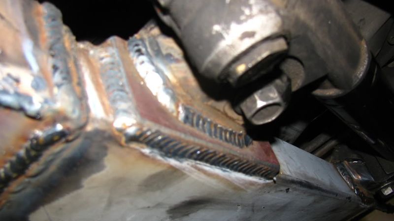

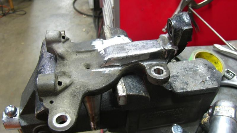

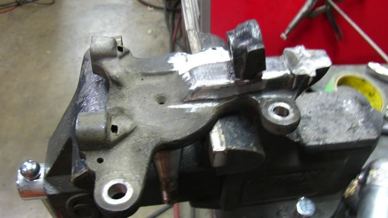

I got some more work done on this thing today ... here are some pics of the spindle mods and the frontend going back together ... its almost done
This setup will lay on 20s with a good size tire, with almost no camber and toe change from laid out to locked up ..

Awesome work! What did you use to weld the spindle? I hear cast is hard to weld.
