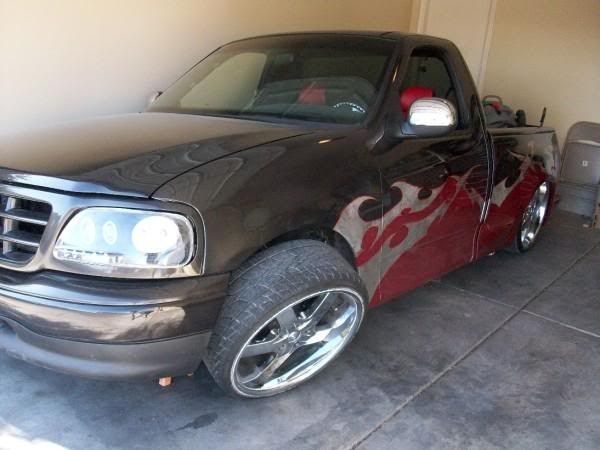

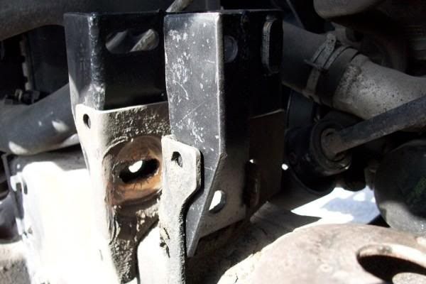

by raising the mount, all he is doing is pushing the the upper ball joint up and out, therefore alleviating the bind on the ball joint. and lessening the camber...and taylor is right about the flipping ball joints, mikey of las vegas had his ball joint flip out in his f150 at 55..he was able to make it home.
this is a pic of the ekstensive bracket on mikey's truck.
my f150 currently lays a 255/35-20 with nothing but drop spindles...stock everything else. and it lays front crossmember.
