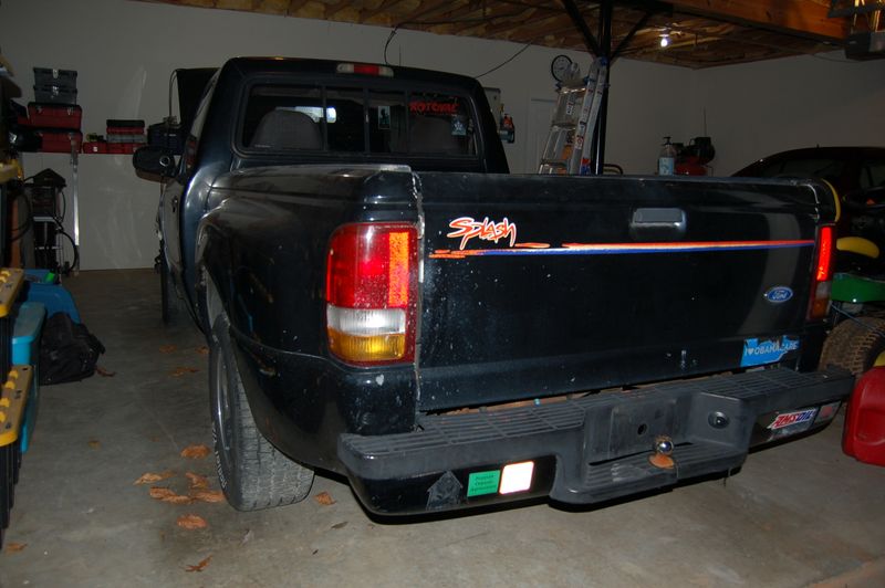

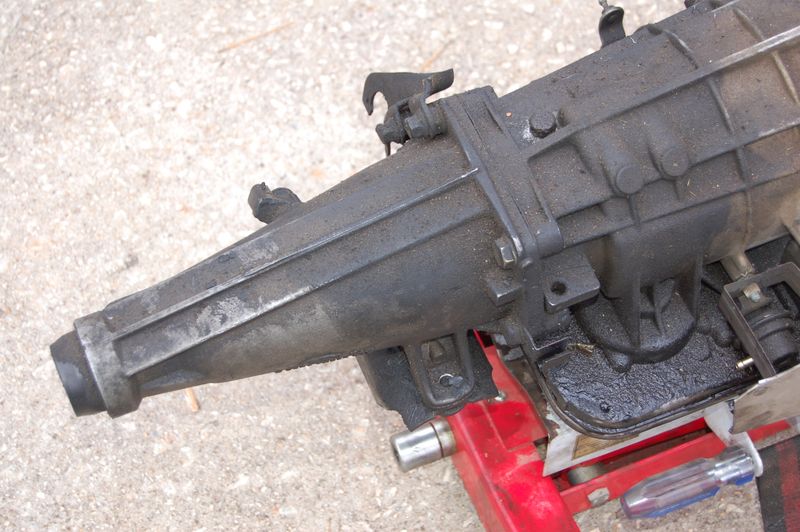

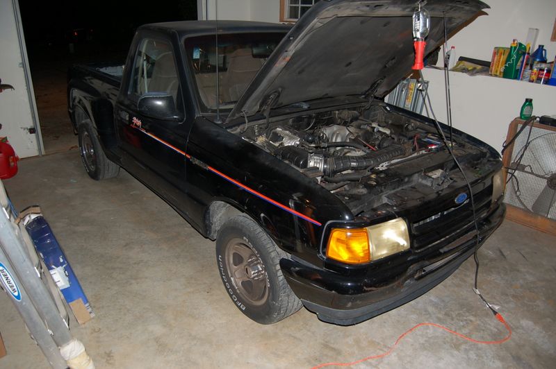

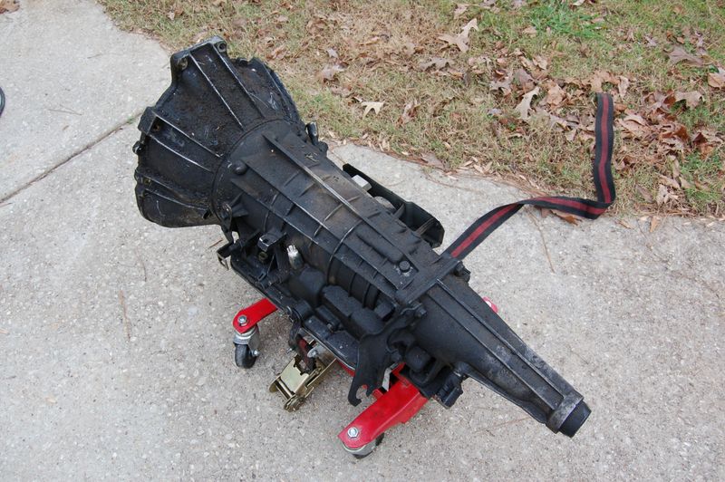

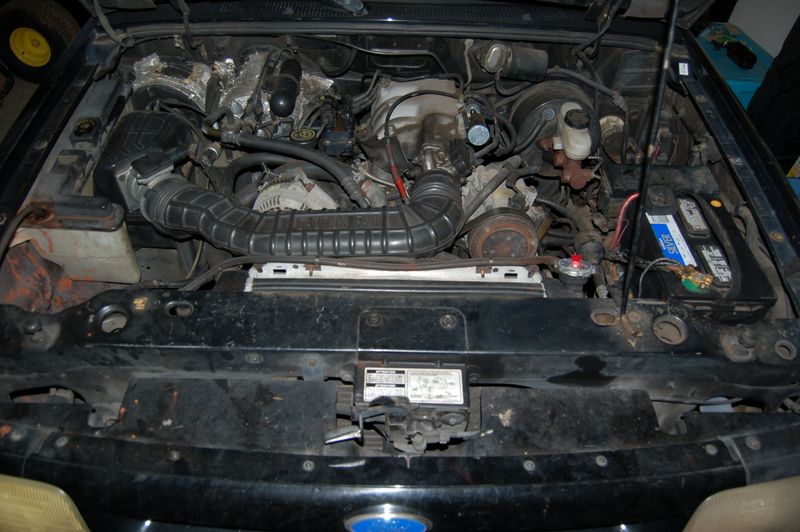

Here are some over view shots of the project truck, it's a 1994 Ranger with over 250k miles. Eventually it will be bagged among other things but for now it needs some work to be drive able. It runs rough but more on the engine fixes later.

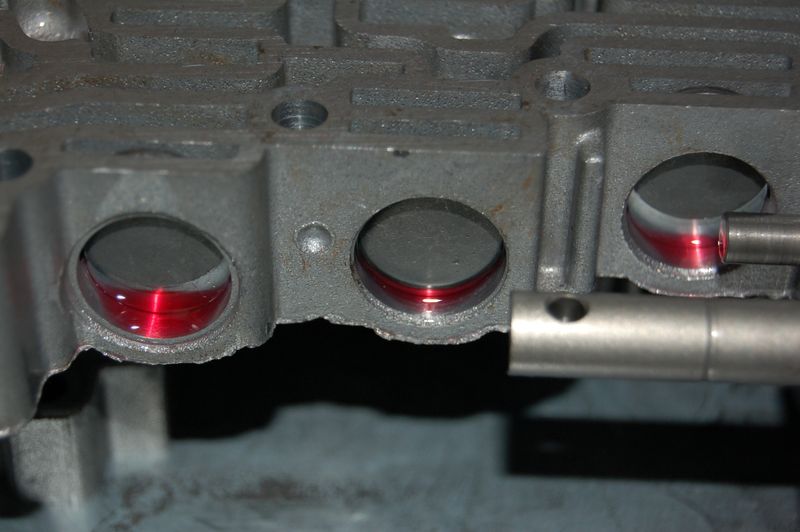

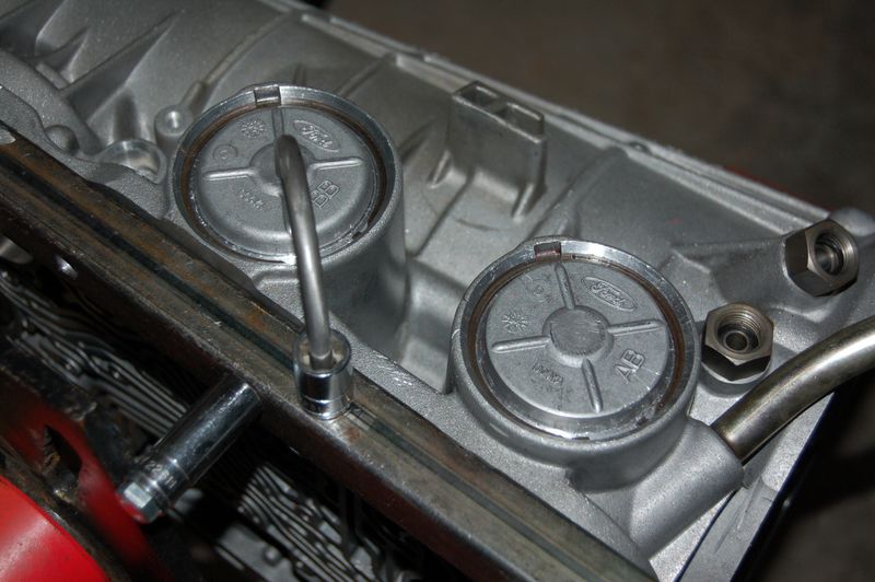

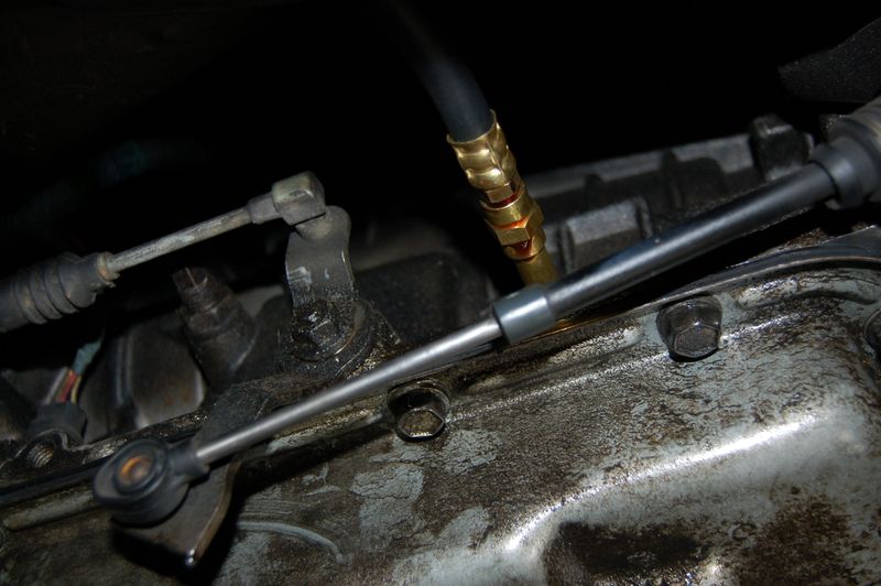

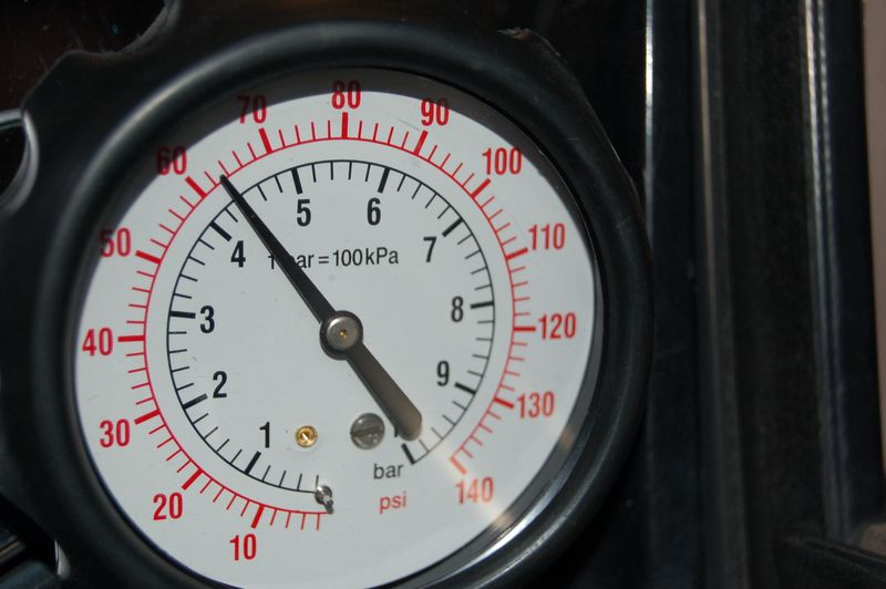

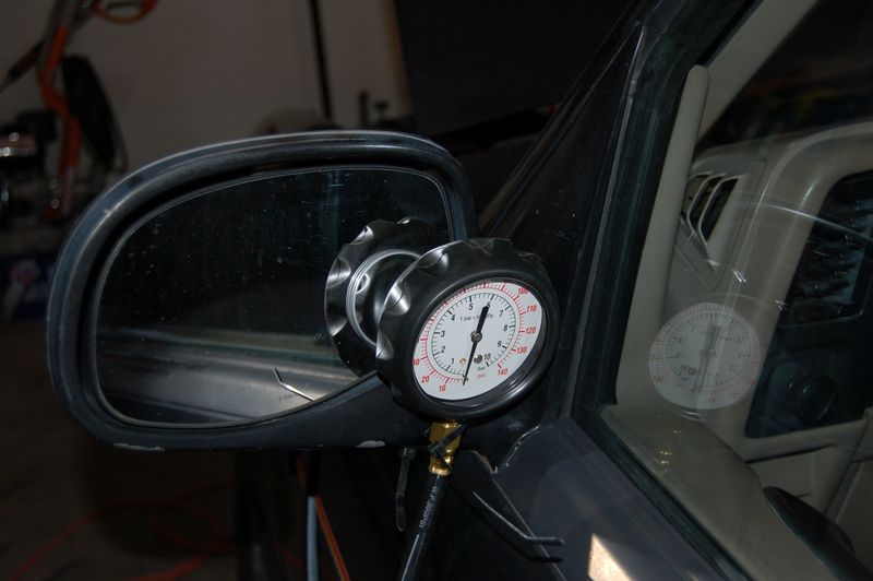

The next step was to check the pressure. One thing I wish I would have done was to get a gauge that could read higher pressure but here are some pics of hooking it up to the test port.So far with in spec.

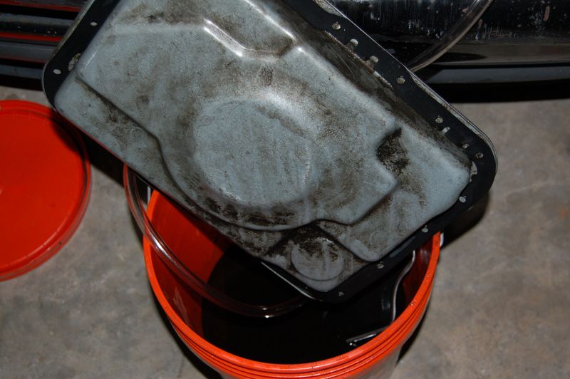

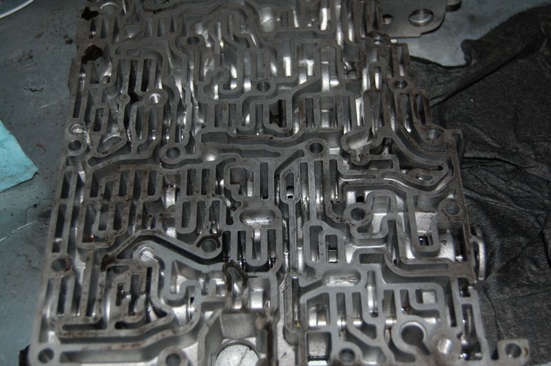

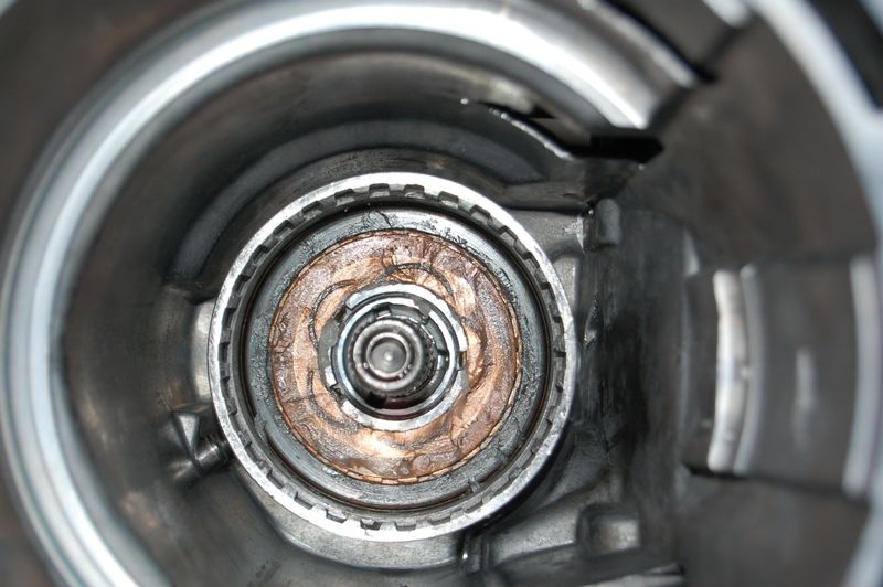

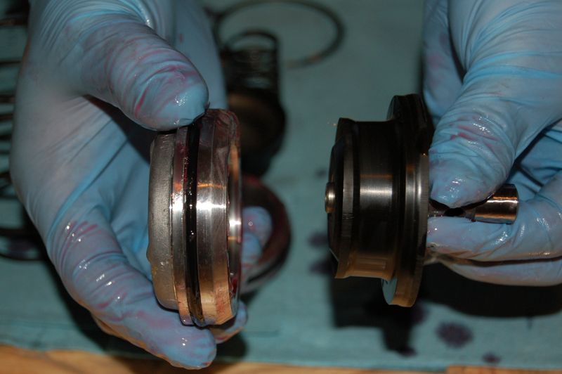

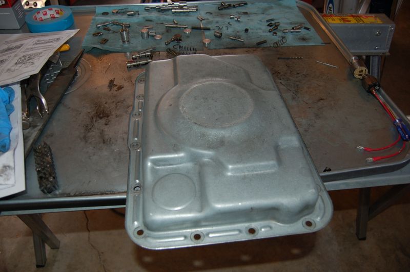

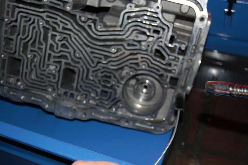

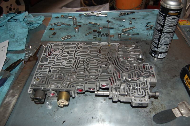

In the end I knew it was going to probably need a rebuild but couldn't help but hope that I would find a simple fix. I scored a deal on a disassembled A4LD for only $85! I knew I might need the extra parts and this I couldn't pass up. I was inspecting the valve body when I found this deal.

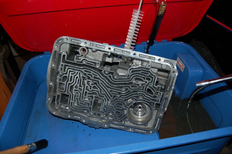

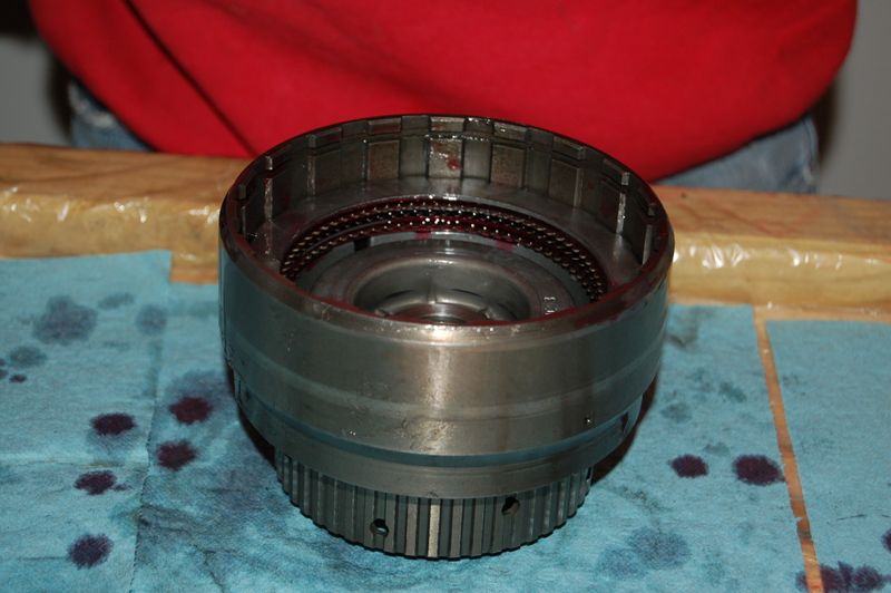

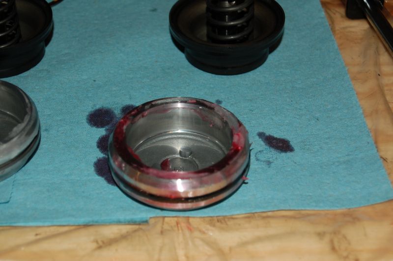

It's hard to tell from the pictures but the fluid is really nasty with a lot of grit. A lot of the valves in the valve body were actually sticking. I really thought I may be looking at a plugged filter and sticking valve body so that was my next step.
Here are a couple pictures from that step, I ended up using the donor valve body since the fluid in it was much much cleaner.

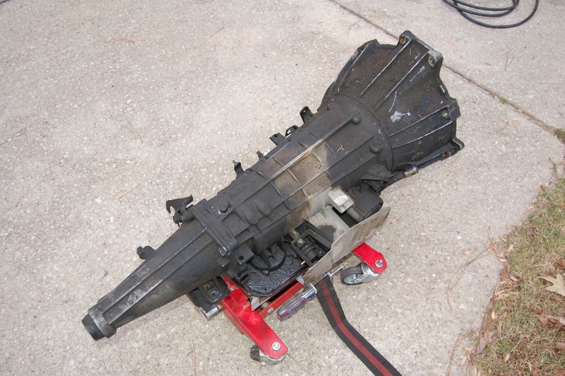

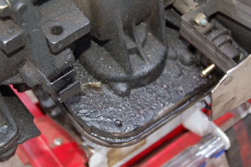

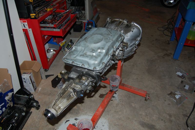

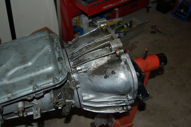

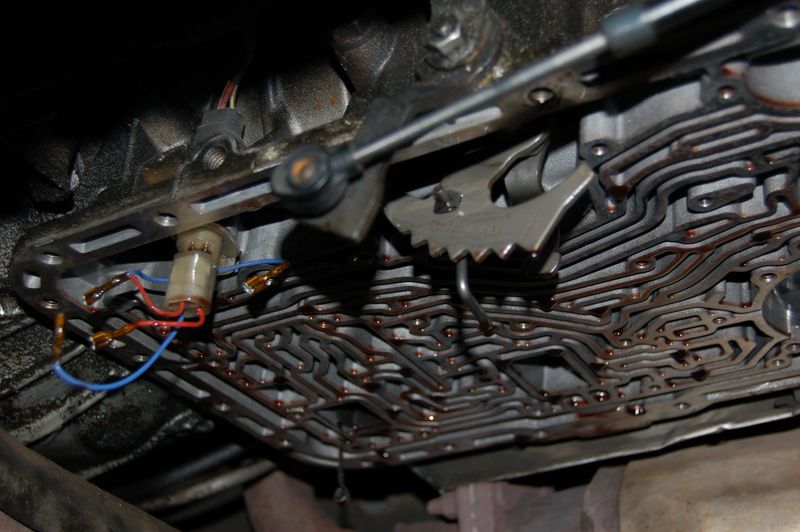

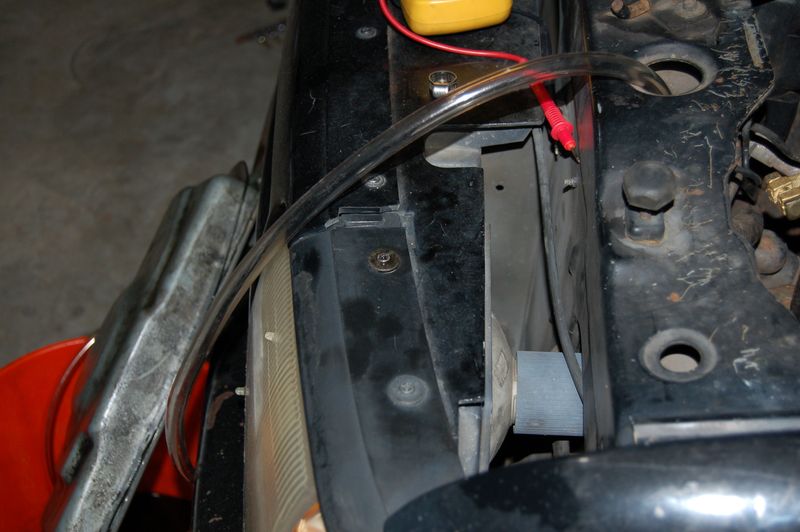

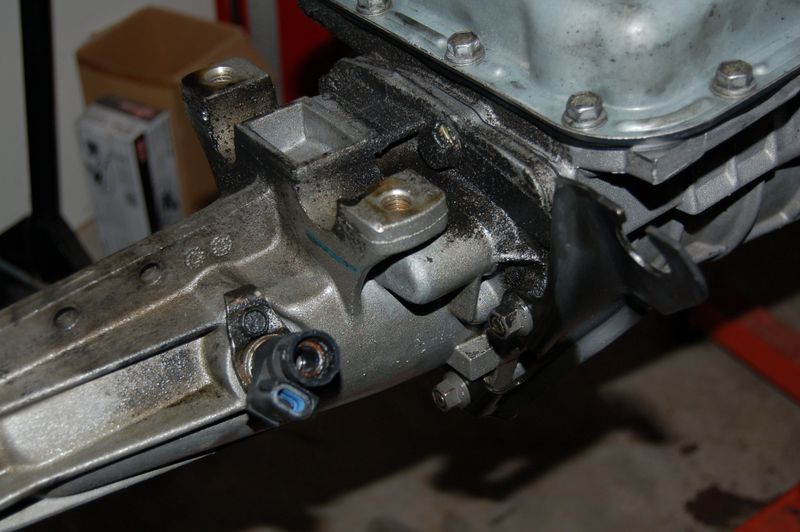

Picked up this trick from another member, using the pump to drain the fluid out of the pan makes it a lot easier! I just used a clear hose and a hose clamp to attach it to the radiator port and ran the truck just enough to drain most of the fluid.
Also here is a picture from underneath.
There is an example of how much cleaner the donor valve body fluid was.

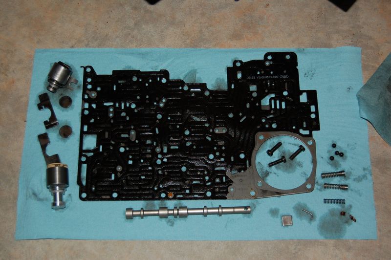

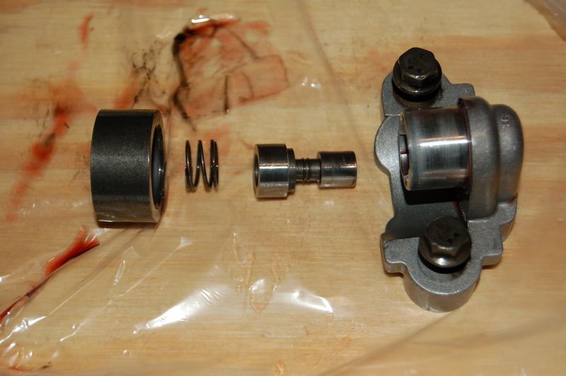

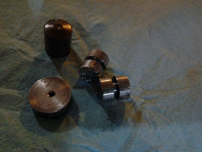

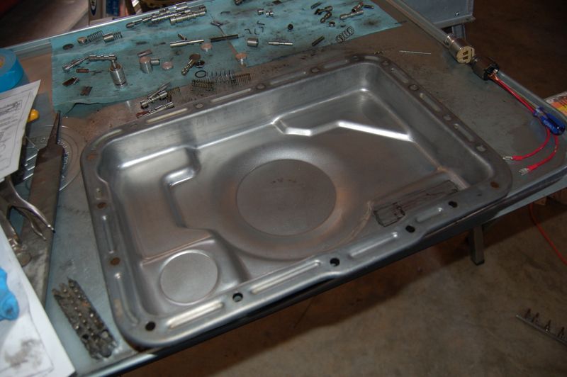

On a side note, I ended up drilling holes in some of the plugs thinking it would be easy to get replacements cheap, well it wasn't, thankfully I have another valve body. If you know a source to buy just the plugs please let me know!

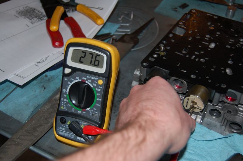

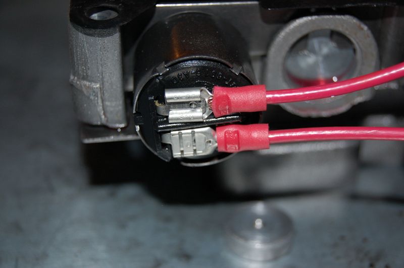

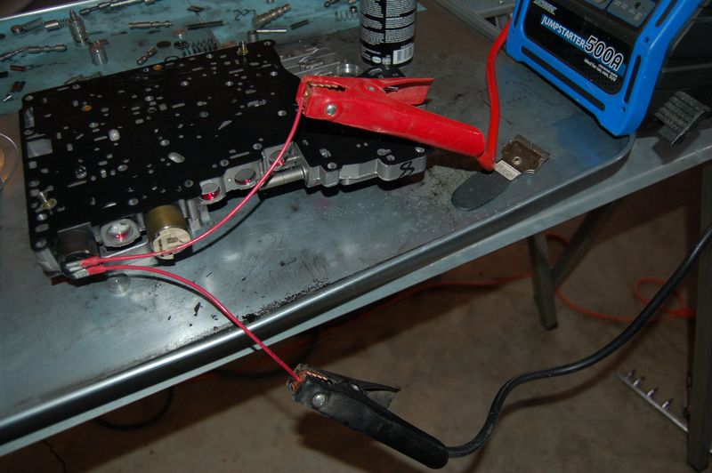

While the valve body was out I also checked the solenoids, one was bad so I replaced it. Here are some pics from doing a simple test. Checking for resistance and also functionality.
